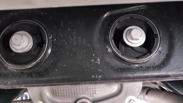

Hate to hijack my own thread but after 8 fun months with you guys, i’m heading back to turtle land with a 3-row Jeep GCL lol. My 1-bolt rear end (courtesy of Ford’s 2021 ingenuity lol) imploded for the second time in less than a month and almost left me stranded in the blue ridge mountains.
What did you mean by this? Sorry to hear.

Look at the rear diff on your ST. I have a 2021 but have two bolts/isolators connecting the rear diff to the subframe. The passenger side one looks to be torqued to about 5,000 ft-lb though. Some 2021 models only have 1. Not sure about the 2020 models.

#49

Sorry to hear this. Also sorry that your Ford dealer couldn't get you sorted. My rear end has two bolts and its so freaking odd they couldn't figure that out for you.
An ST with only 1 bolt in the rear...the equiv of having a gf/wife w/only 1 b@@b lol and that's the boat ive been in unfortunately...
Thanks. Just checked my early build 2020. I have two bolts. Can't believe they would put just one bolt on some and not others. i wonder if that was intentional or by mistake. they really should recall the one bolt vehicles.
Could you elaborate? Looking at your earlier thread, I assumed that the second bolt had simply been missed during construction since the slot was there for it. Looking at the mechanic's statement, it's hard to tell whether a single bolt had snapped or one bolt had snapped on the passenger side. To be clear, after they "fixed" it, it still only had one bolt??
1 bolt from factory, that bolt sheered in half, it was then replaced by Ford, then returned to me with 1 new bolt, the new bolt sheered in half a couple weeks later. Was told by dealer that they contacted higher ups at Ford to triple check that i wasnt missing the 2nd bolt. Ford confirmed only 1 bolt required. I then decided to give up on Ford…

I'm not sure whether Ford is completely screwed up or your dealer (and service reps) are fools. Does anyone else on this site actually have just a single bolt securing their rear diff to the subframe? Mine certainly has two.

Thread Starter #58
some guy in the FB group just had hte same thing happen to him w/1 bolt. My dealer has 2 2021 STs on the lot w/1 bolt each

Thanks for the info. I'm glad I have two, but who was the brainiac engineer who decided one was ok to save a few bucks? Normally there's a pretty significant process to make an engineering change like that.
