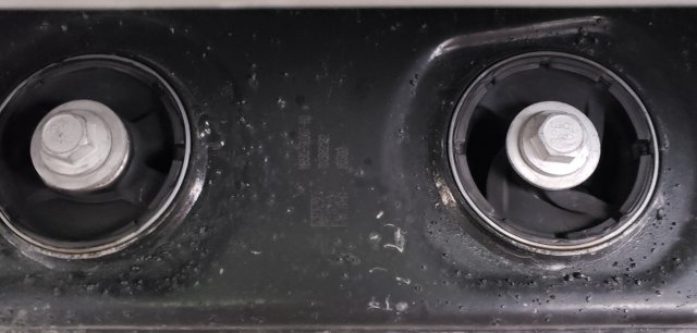

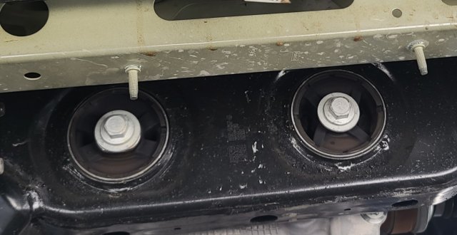

#69
5BAD431B-7A5D-4591-BF73-B86E3C6EEC44.jpeg 31B4019A-486D-421C-97C7-B589BE08DBB3.jpeg
Posted for quick visual comparison.
Clearly, this change was intentional. Even the bushing in the single is different.
I previously thought a 2021 would be getting all the kinks out of 2020s but it turns out there's a heck of a lot of cost cutting that was done.

#70
So the bushing design changed...
I need to see if I have that bushing on mine with the large metal center.
That likely is what allows them to go to a single bolt vs. the 2. That design likely has a lot less flex/deflection than the original 2 bushings and the second bushing then was not needed. The older bushings look like when they are installed they get twisted/distorted from the get go likely causing issues. likely not optimal and not as designed, so the engineers likely went back to re-design things and also figured out that with the new design, 2 werent needed.

#71
Yeah, good point about possibly a single bolt getting the old bushings and failing. I still think a single is not as good because it's not centered relative to the differential. The differential was probably designed to be mounted with the two bushings but they decided to save $50 and go single.

#75
View attachment 7118 View attachment 7119
Yeah, different design altogether. Knowing Ford tho, pretty sure there was next to no testing on the newer design to see how it holds up.
As rjacobs said, could probably not be a huge deal, just interesting change tho.

#76
interesting that the bushings on the two bolts are different and oriented differently also.
blaster9 says another owner on FB with one bolt had the same issue. 2 cases to me is enough to be a potential problem.
