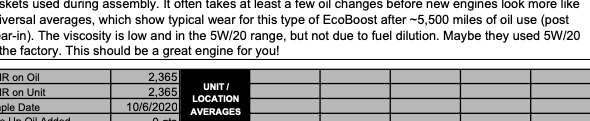

while not break-in oil persay, a few of us have sent our first oil changes to blackstone (search for the thread on here). it came back 5w-20. so the factory fill up IS different than what is recommended in the user manual. i will be updating that thread with all my oil change results so we should be able to get a good look at the type of wear this motor experiences. i changed out the stock oil for Mobil 1 5w-30 full synthetic.

While I didn’t do a Blackstone oil analysis on this motor, I have on previous ones and with GDI engines, there is the factor of fuel dilution that happens which does reduce the viscosity of the oil.

Per Blackstone... there was no fuel in the oil
