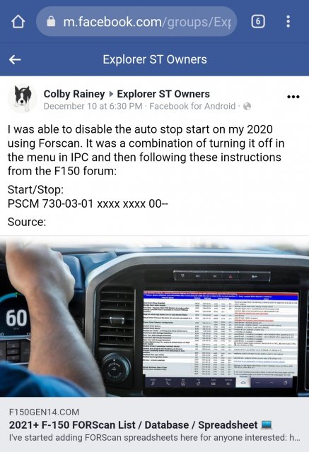

#57
Using forscan is a viable option if you already have a license and the needed adapter to plug into the obd2 port, and know how to use forscan. But if you don't know how to, you can brick a module or you entire vehicle. Just getting the license and adapter will run you close to 100 bucks anyway, so at that point why take a chance with possible damage to a module, just buy the autostop eliminator.
If that’s all you’re planning on doing with ForScan then yes, just get the AS Eliminator and be done. But if you already use FS and you’re proficient enough with it, do it that way. There’s been a lot of attempts to use FS for this and no one has succeeded until now.

#59
If I already had FS and was proficient, then I would have gone that route. But I don't and I'm not, so the AS was a more logical choice for me. Also if I had known you could have it turned off via a tune, I would have not bought the AS because I planned on getting it tuned as soon as I possibly could. I installed the AS at the dealer in the new car prep lane while they were getting the paperwork ready, so I never drove it with the AS active. About a month later I bought a set of tunes for it and that is when I found out the AS feature could be turned of via tune.
I remember bricking a motherboard on a computer trying to update the B.I.O.S. back when win95 was still the main OS out there and you had to download the bios update over a dialup modem and load it onto a 3.5" floppy. And back in those days an average desktop PC would cost around 1500 to 2K so you can understand my hesitancy to try using FS on a 56K suv that is my DD

#60
Yep, I understand where you’re coming. Nothing wrong in playing it safe, that’s for sure. The only changes I made with FS is the double honk, fogs w/hi beams, LED’s and fake engine noise.
