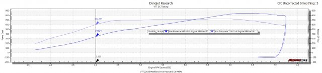

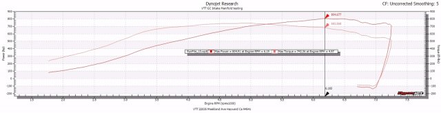

That's the nicest graph I've seen but still quite higher than advertised limits, which is totally fine by me for those currently pushing the platform.
I meant no disrespect but just about every dyno I've seen has a big torque peak down low followed by a steep fall off. I understand holding back the turbo potential but most I've seen aren't anywhere near that linear. Very nice work on that one.
Here's one of the N54 cars I've done for a shop with what I'm talking about, nice and flat like the one you posted.
Your last statement is absolutely untrue. The good tuners are not “just pushing torque out”…they’re actually holding it back. They’re capable of much more then the good tuners are throwing at them.
They also do know what’s safe for the driveline which is why they’re holding back where it’s needed.
I disagree, here's a dyno of a tuned ST vs stock, I see a lot done like this and it's not anything that I'm interested in. 5 star tuning but seems other tuners do this a lot here.
Of course we're going to be pushing it above the limits the 10r60 is only rated for 600 NM (442 ft-lbs)f input torque. But that's at full life expectancy, and full Duty including towing and everything else. You have to remember this thing has a 5600 pound tow rating on top of the 5000 lb suv. You really can't compare it to a car transmission these are much more heavy-duty and robust design because of the tow rating. Of course you don't just get to add power to these things for free everything comes at cost over the life of the trans. Long term the increase in torque isn't going have a huge impact as long as the car is being cared for and you're not doing something like Towing on a performance tune. Everything is built with a factor of safety we are simply eating into that factor of safety in terms of the important torque.
This is very similar the the 10r80, 800nm 590 ft-lbs input torque rating. They are regularly pushed over 600 ft-lbs to the wheels. Infact we really don't start seeing long-term issues with the them until 750 foot pounds at the wheels.
We all know we are pushing the platform. The stock trans has been holding up just fine to around 530 ft-lb at the wheels. That's typically what I limit the torque to. The dyno chart above is from a bigger turbo st that's the record holder for et and trap speed. At the time of the dyno it was on the stock transmission and now it is on a built transmission.
The biggest downfall I have seen with these Transmissions is Tunes I have the transmission shifting extremely soft. Generally speaking the softer the shift the more time you're spending "on the clutches". Ie when the clutches are slipping to hand off to the next great. The longer they slip the more wear and tear in the more heat you build etc.
I said good tuners. I don’t put 5 Star on that list.
