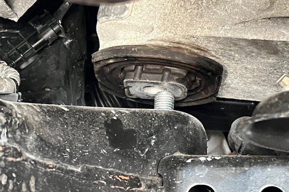

Check the bolt that goes through the sub-frame to the left rear engine mount. I had this issue after they worked on my vehicle and come to find out, they stripped the bolt. It wasn't until we were under it doing something and I noticed this:
The "clunk" had stopped so I wasn't looking for it anymore. The clunking was from the engine flexing up and down until it finally jumped on top of the bolt. May not be your issue but, it's an easy check just to be sure.
