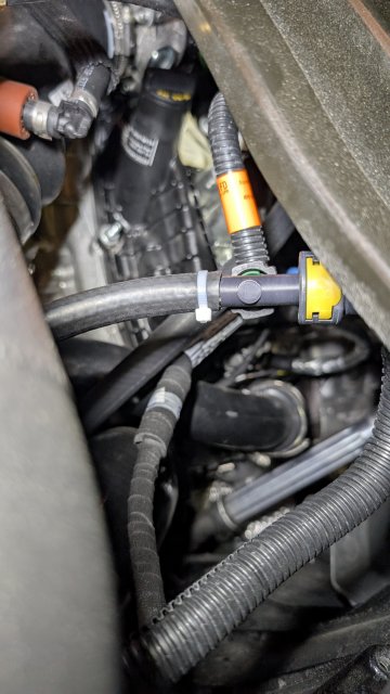

NAiLs
Wisconsin
I installed my V2 a couple of weeks ago and also got this same code just now (I don't drive much)... Pretty annoyed to see people say it's an "installer error" and offer no suggestions other than the obvious that has already been done by everyone. Also, this isn't my first rodeo nor my first ST with an intake on it.
All of my connections look great and tight. The only one that I may have skipped on is the hose that goes from their silly 3D printed part to the intake pipe. I carefully slapped a zip tie on the 3D printed side, ensured it was tighter, but I'm afraid of this part breaking because it wasn't designed and printed well. I also am debating on shortening the hose that came with, because it feels a wee bit long and that may contribute to the issue. This 3D printed part is the only weird part of this intake, otherwise it's awesome.
I've got a little driving to do today and will see if the light turns off after the zip tie.

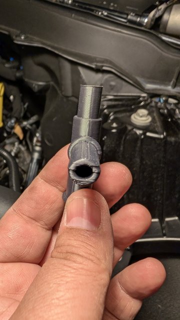

Agreed to everything you just said. I just threw the same code last night and came to the same conclusion about the crappy 3D printed T fitting. Look familiar?

NAiLs
Wisconsin
View attachment 29180 View attachment 29181
Yep - that's it! That piece is the only part of the intake that I'm unhappy with. I'd rather have seen these connections just go right to the pipes like factory, rather than using this silly part and adding yet another hose so the car can collect the data. I still have an AFE intake from my previous ST and that one was perfect with how all of the connections were made.
93
51
Illinois
One other thing I noticed about this connector that I have been thinking about. While cleaning some of the flash off it before connecting the hoses, I looked down the center if it to ensure there was no debris in there. It appeared to be necked down towards the center of the long side, the inner diameter of the tube was reduced and smaller in this section. I stuck a pick down there to make sure it was not another part of flash let over from a bad print job but it appeared solid like it was programmed to print that way. Did you look in yours by any chance and see the same thing?
I want to replace this fitting with something more OEM looking but do not know what these fittings are called. Any idea?

I talked to Brett from FenFab. The 3D printed tee is for the evap system to bring the vapors back into the intake instead of atmosphere. Brett explained the P2C90 is due to the lower turbo intake hose up to the driver side valve cover. Check that the 90° barbed fitting is tight and the hose is snug.

Interesting.... I will check that today. Was yours loose at all? I still think the hose that we zip tied (soon to be a worm clamp) on the t-fitting was good to do. It was actually pretty loose when it gets warmed up.
