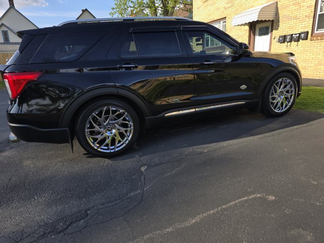

I went with Lethal Performance 2" ones ? Yikes , its close
Killer stance tho'

How she lookin' ?
