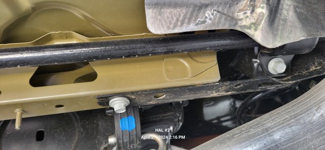

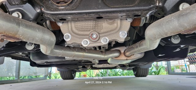

so the 250 million dollar question
can we buy the 4th bolt and bushing and use the factory mounts to add the extra bolt?
2,056
1,436
#87
You can definitely replace the whole crossmember with a 4 bolt so long as you have the second hole on the diff cover. I did this a couple years ago.
As far as adding the 2nd bushing yourself, should not be a problem so long as you can get the 2nd bushing and have the 2 bolt diff cover or get one and have some mechanical skills.

#89
You would need to cut out a hole in the subframe and weld in a sleeve that houses the bushing. Definitely not going to be a simple job.
297
185
San Francisco
2022 ST
#90
As mentioned above - that is no-can-do.
What is missing?
- A HOLE in the subframe where the bushing sleeve goes
- a tapered bushing sleeve
- the bushing itself
For you to cut both sides of the hole and weld on both sides, you have to drop the crossmember and remove everything, which is all of the work.
If you're going to do all that work, just buy the 4 bolt Aviator crossmember and be done with it. Why screw around?

#92
I think the hole is there
Bless your heart. There is simply no way to “add” another bushing/mount to a 3-bolt rear subframe. If you spend a bit of time reading the several threads on it, there is much information.

#94
You are looking in the wrong place.
Look at your first image, at the top is a black subframe (You see the bottom half of the diff).
If you look, you'll see a big circle with a bolt on the left, then the subframe is "whole" in the circular impression to the right.
(The bushing is like 2" round)
2,056
1,436
#95
Agree you would have to pull the crossmember to fab the new bushing in. For somebody with fab skills it does not look too hard to do but like mentioned, at that point the aviator crossmember is easier albeit more expensive.
