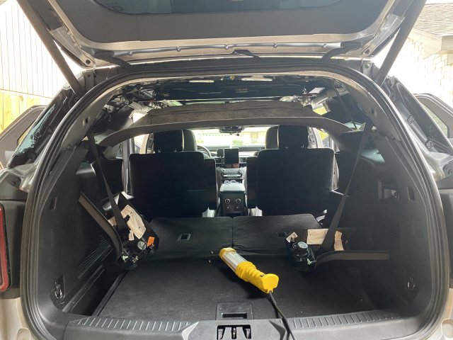

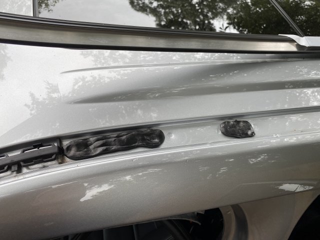

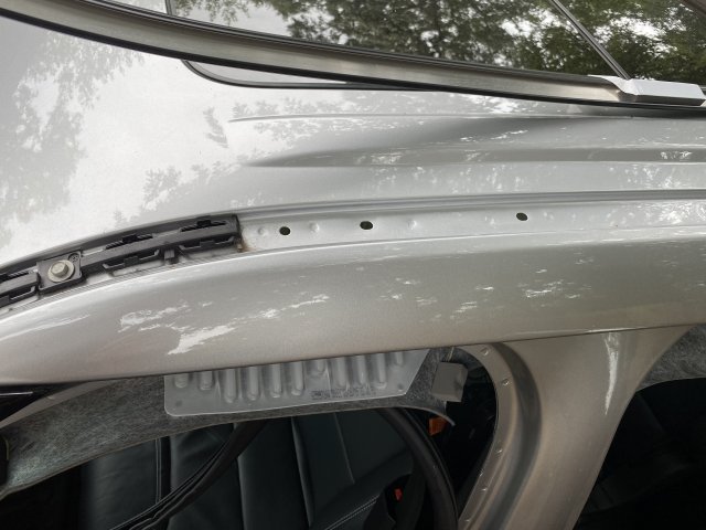

All in all it wasn’t too bad. 4 hours start to finish and the first 2 hours was figuring out how to disassemble everything. I had no idea the headliner around the pano roof is held up with magnets. lol
After you get the headliner down it’s 4 10mm nuts per side and a couple of push in clips and pop it right off. The new ones only use 2 nuts and all the same attachments as the bars. We’ve all been ordering 4 pieces but only the 2 main pieces are needed. You’ll have to fill 3 unused holes with something...I used some butyl rope I had in the garage from an old headlight build. D2CA8DD7-2F0C-4E13-935B-B9E6EEB7184B.jpeg 8FA4D2A2-B14C-4751-A8A1-AEB86950EF01.jpeg 9DE1D766-05F4-467B-B095-AD2B5963AC15.jpeg 24B9A370-4026-47EC-B58D-DAD7356BDE44.jpeg D1B3A22F-B308-4162-8185-36B5A0286975.jpeg
