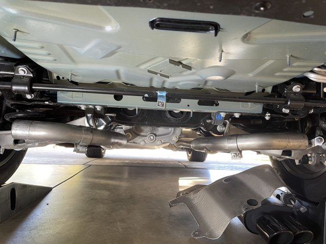

Here are some action shots. Super easier with the Borla exhaust.

hmmm, that Steeda bar looks significantly more narrow than stock. I thought Steeda revised the bar to avoid contact with the springs? That looks like it could be problematic with stock and H&R springs.

No contact with springs, however, it is close. The Steeda bar is much heavier but I did not think about thickness. Did not seem to be skinner.

Keep an eye on it. the bar can shift side to side a little.
I was not saying it's skinnier. It definitely is thicker. But the overall width ( or some would say length) from end-to-end is shorter than stock. That was the problem with version 1 of the bar as people with H&R or stock springs had contact from the angled ends. I just hope they did not mistakenly go back to the old design.

His bend looks slightly different than mine. I think he has the revised bar. There really is no reason for the middle and softest settings. I have no idea why they don't just chop those off (I did on mine). Its gives way more room and eliminates any issues with H&R fitment. Plus nobody runs their bar in anything but the stiffest setting.
