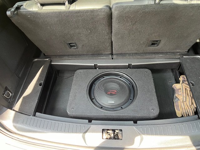

I have a 10" Alpine sub and it fits right in the rear storage compartment. It's obviously not gonna win any awards but, combined with the Focal woofers in the doors, it's plenty loud enough for the average person.

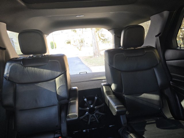

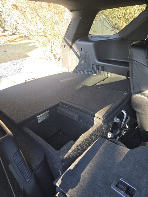

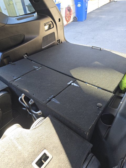

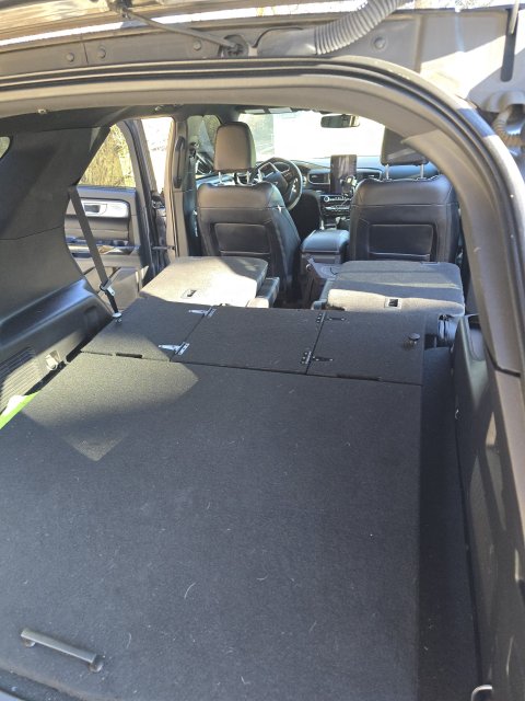

I removed the 3rd row seats and added a whole complete part from the hatch to rhe 2nd row captions seats . I added a front firing sub and a large storage and 2 small storage spots
1,705
1,170
Here are a few more pics. I put a blackbird and a sub amp in where the old sub was ..
WOW! That's a nice set up! Good work. I also put my amps where the OEM sub was.
You don't happen to have the build plans for this, do you??
Very nice! Love the storage. I did similar but mine is a complete lift up storage area from lift gate to back of second row that will fit rifles and my amps are where the spare tire was. It also has a stealth key lock. I put a JL Audio TW5v2 13” sub in the oem spot in a custom fiberglass box I made for the oem location.

Sorry just saw this , I just made it on the fly so I dont have any plans ... but if I can help you I will , plus it sounds like someone else on this thread did just about what I did
