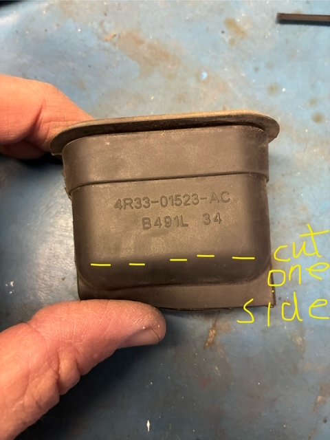

Did you clean out the bladder that is up higher attached to the firewall? STWetFloorBoard.jpg

Update on driver side wet floor on my 2022 ST:
-Driver side floor became wet after driving in a heavy rain on 5/2/2025.
-The floor does not get wet while parked or driving in light rain.
-I checked the drain tube 4R33-01523-AC (I called it a drain bladder) and it was clean.
-In the past I have also checked the sunroof drains and they were clean.
New speculation: The pinch opening of the bottom of the rubber drain tube behind the wheel well splash guard is being overwhelmed by the volume of water when operating the vehicle in heavy rains. On the Gen 6 Explorers, both of the windshield wipers sweep rain from the passenger side to the driver side forcing the majority of the rain to the driver side drain.
Solution: 5/5/25 I modified the driver side drain tube by cutting a portion of the bottom of it off in order that the tube is ALWAYS open. I only cut off one side of the pinch opening in order to maintain the original length of the rubber drain.
Status: No wet floor to date.

In both corners of the window cowl/wiper area, both drain to the outer edge where there is a gap that leaves can also accumulate and fall into the drain area with the bladder. Bad design!
Yep, plan pull out some extra leaves in there in a couple of days.
