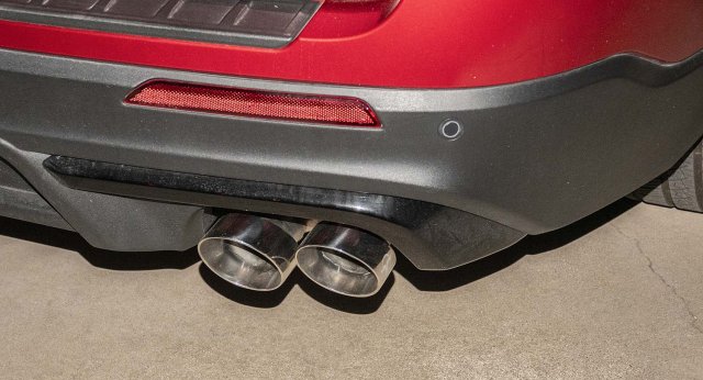

I love my Thermal exhaust with SPD downpipes! I think it’s the perfect sound.
