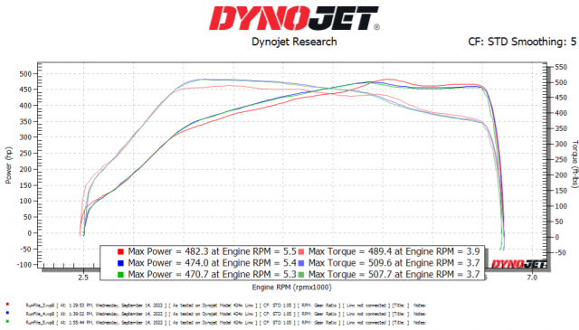

~Update~
I had my ST dyno'd today and the dyno before the Whoosh Motorsports downpipes I maxed 458awhp to the wheels.
After the downpipes were installed, I maxed 482awhp today. Max gain of 24awhp!!!!

Cool! Show us the dyno sheets.

#39
Those are some significant gains, but what was the temp & humidity like between those two runs? The initial pulls were done on July 25 and the DP pulls were done on September 14. I'd imagine it would be cooler during mid-Sept than during the dog days of summer.
Obviously, it would still gain, but with a back-to-back dyno post install, I think you might see less of a gain. The stock design of the downpipes are pretty terrible though, so it's not surprising that there's a good amount to be gained by doing this mod.

#40
I live in South Carolina, where the weather is very humid and hot, well into late September. For both of these dyno days, temp was in the 90s, and very humid.
I hope this helps.
