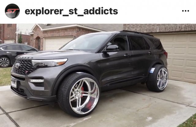

is it sacrilage that whenever i see that image, i imagine what a DONK'd ST would look like? ... and then think it would be cool. :unsure:

See what happens when you don't get the measurements right? LOL?!
Was he dyslexic or was he reading the tape measure upside down? Maybe those shiny bits were supposed to face inside :ROFLMAO:

His kids asked him for a place to sit while he wipes down the ST.

Maybe he uses them as steps to wipe down the top of that thing.

The guy owns a wheel shop here. He just did it as a joke.

Oh, that would explain why the stickers are still on the tires. I thought maybe it belonged to Minnie Pearl
