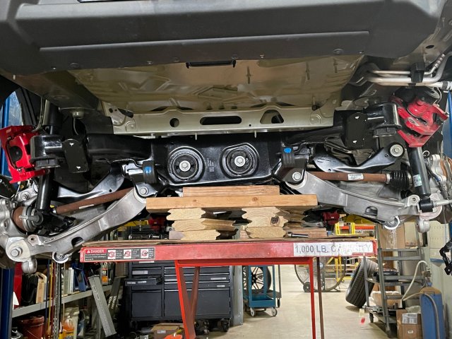

More pics showing assembly.

Last one of crossmember.

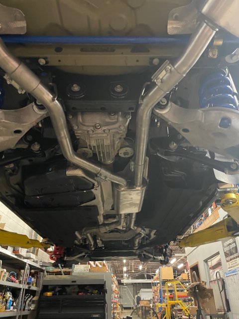

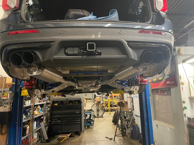

Once the crossmember was back in I took about 15 minutes to install the Thermal Exhaust. It could not have been easier. Laid the parts out on the floor and put them in. Super easy to get everything aligned especially the tips.

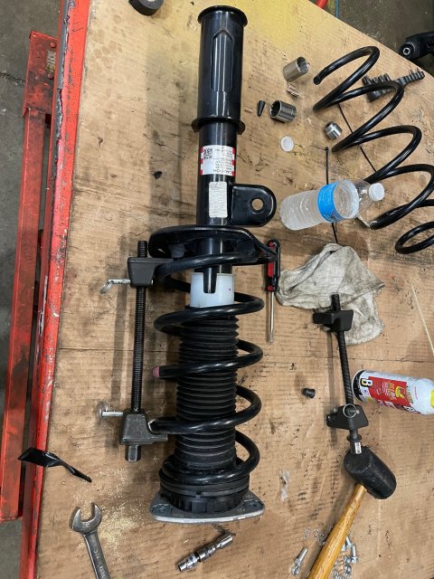

So out with the struts and in with the Steeda springs. This was pretty simple compared to the last couple days.

Third mistake. When I took the spring off the first strut, the bearing cage of the top mount came apart and shed about 15 of 40 ball bearings. Had to search for them, clean them up, then carefully put them back together. The top bearing is basically two plastic halves with the ball bearings sandwiched between them. It simply snaps together....and apparently unsnaps quite easily.

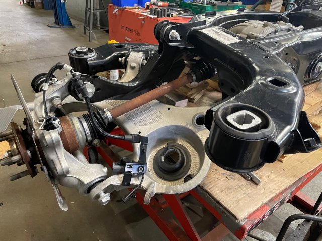

From the looks of it why couldn't you just unbolt the LCA's and remove the big bolts holding the diff carrier and lift the subframe off the whole assembly? Leaving the axles in place and the knuckle all attached.
Yeah I was trying to figure out a better way. In the end, I decided to follow the procedure from the shop manual so as to avoid painting myself in a corner so to speak.

I can also say for sure that the Ford “tech” won’t follow the entire procedure. They will cut time by only removing the back half of exhaust, pop the drive shaft out of the diff with a pry bar, drop the entire assy onto the floor, take the control arms off at the subframe leaving the half-shafts and knuckles connected, and lift the rear of the subframe and slide it forward a bit and lift it right off. It saves them a LOT of time in the procedure, so they make 8 hrs’ money in less time. Less new bolts actually used, but charged to the customer anyway so the shop makes some extra bucks too. Flat rate is a racket in oems and repair shops.

Took it for a shakedown cruise and found nothing weird happening. Alignment must be close too since it tracks pretty good. Might wait a few days to let the springs settle a little before my alignment. Definitely handles better with the upgraded rear sway bar. Oh and I LOVE the sound of the Thermal.
