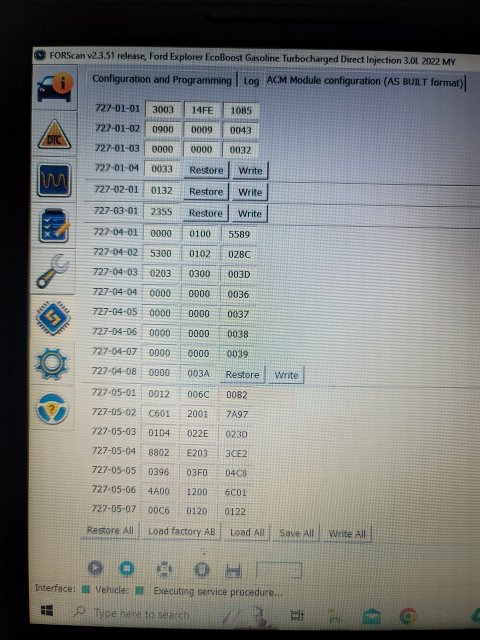

I tried that today but I keep getting an error when trying to write it. "Service Procedure has been interrupted". Not sure what the issue is. Im running the latest Forscan version.
Tried last night to delete FENG in forscan (I am running the latest version and have OBX MX cable with updates) and got this same error
I found 2 separate headings in the ACM configuration for it one "Engine Noise Enhancement" and the other "Software Engine Noice Enhancement". Which one is it or do both have to be change?
Neither would on either of them in the Easy Config method. I did go into the "As Built" to check it out and seems Ford re-wrote the entry as the following instructions won't work because my code has the number 4 where the X is.
"Make a change the following "X" to "9" (should be the top line) if not 9 try 0.
727-01-01 3003 1XFE 1083"
Can I change the 4 to a 9 or 0?
Sorry for being such a newb!! I just don't want to F things up.

Anyway I got the adapter FORScan recomended and the 2 month free code. Unfortunatelly when I access FORScan and connect to my vehicle, I can access the ACM, but it only gives me options to access the code 727-01-01 with program codes and does not offer a disable/enable option. Does anyone know the program code to turn FENG off. My current code is 3003 14FE 1085.

Change the sixth digit, 4 to a 0 then write.
3003 10FE 1085.
