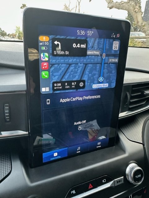

5. Access to full screen mode all time (Nav, entertainment...)

What’s #5 ?
And are you doing Bambi mode?

This screen should be all map. The fact it is sectioned off for anything I am not using (audio in this case) is annoying. Seems like an obvious flaw.
so #5 makes it 'all map'?

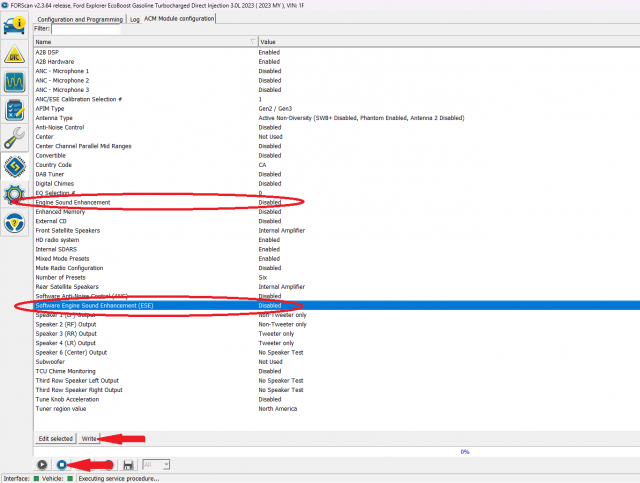

Thanks for all who bothered to share the knowledge on this thread!
2023 Explorer ST - Process worked like a charm. Its no V8 but the genuine engine noise is so much more beautiful than the FENG... Can't believe I even had to do this crap Lol.
For anyone else still uncertain on the process - See below and attached picture. I opted to do it via the ACM Module Config menu instead of the coded style As-Built screen.
Firstly I found this video great because I also wanted to disable the double honk door chime as part of this process. But it also was a good video explanation of the process of hooking up Forscan, where to click, etc for the uninitiated.

Only real issue with disabling feng...is loss of active noise control
In my area tye high traction asphalt
Makes keeping anc enabled a plus
