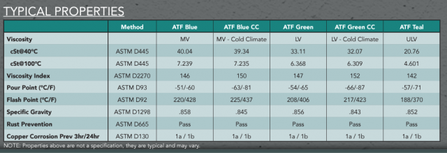

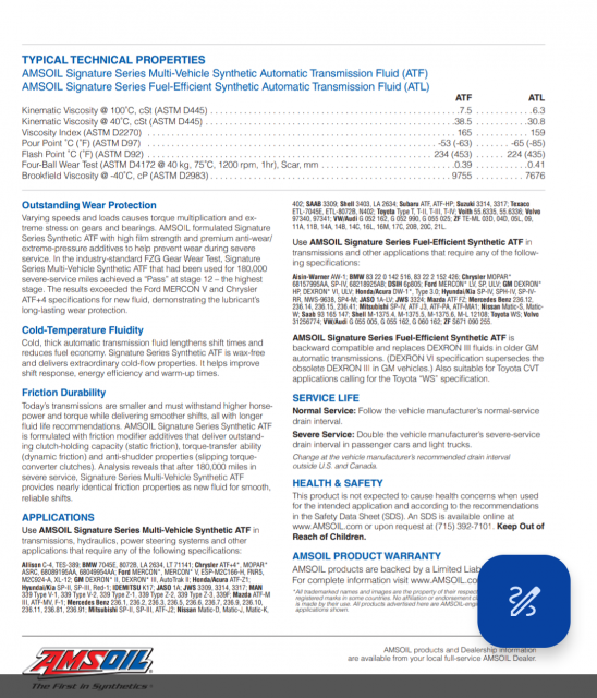

Mercon ULV viscosity = 4.5cst @ 100C (19.2cst @40C)
Amsoil SS FE ATF = 6.3cst @ 100C (30.8cst @40C)
Simply put, you would have to run the Amsoil SS 15-20F hotter for the same viscosity at a given point that your ULV would supposedly be at. This probably isn't a very big deal once the fluid is up to operating temp, and might even be somewhat beneficial to people who like to run their vehicles hard. But the shift programming is still going to be calibrated (optimally) for the ULV viscosity to temperature relation. The biggest concern, is that the ATF is going to be thicker, more resistant to flow and yield higher line pressures (Pressure = resistance to flow; higher oil/line pressure is NOT always a good thing) when cold while coming up to operating temp. Especially for those of us who operate our vehicles year round in cold climates.
This would be about the ATF equivalent of running a heavier weight engine oil than called for, which should only be done under extreme circumstances (Hard competition use, such as road racing where the oil is continuously operated at higher than normal temps). Obviously people aren't going to be starting those types of vehicles in their driveway when it's 20F outside and going to the store for milk and bread (or at least they shouldn't be). Viscosity is primarily based and chosen on tolerances and bearing clearances, and the principle is no different in a transmission. In fact, it is ESPECIALLY important in an automatic transmission where more viscosity is going to be reducing flow through all those tiny little passages.
Amsoil and alot of their dealers will rebuttal with sales jargon and tell you it's OK to use, as well as the factory fluid being the wrong viscosity. But that's a particularly bold claim that engineers working for two of the largest auto manufacturers in the United States don't know any better over a salesman maintaining a side hustle. They engineered these units to be more efficient and designed the fluid to those specifications.
Your ride and your call, but personally, I'll wait until Amsoil comes out with a properly spec'd fluid before I dump it in anything calling for a ULV.

Someone posted one a few clicks above with the correct viscosity. Also, Valvoline makes a full synthetic ULV with the correct viscosities. I'm also a personal fan of using Lubegard red. I've had good results with everything I've put it in.
I'm not saying that Amsoil is a bad product, I'm saying that currently, they do not have anything correctly spec'd for a ULV fluid despite claiming that their "Fuel Efficient" LV certified ATF is also acceptable for use in ULV transmissions.
