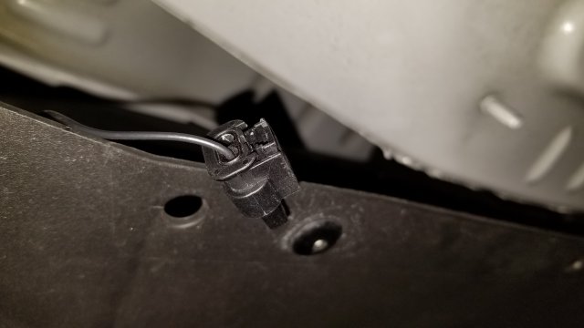

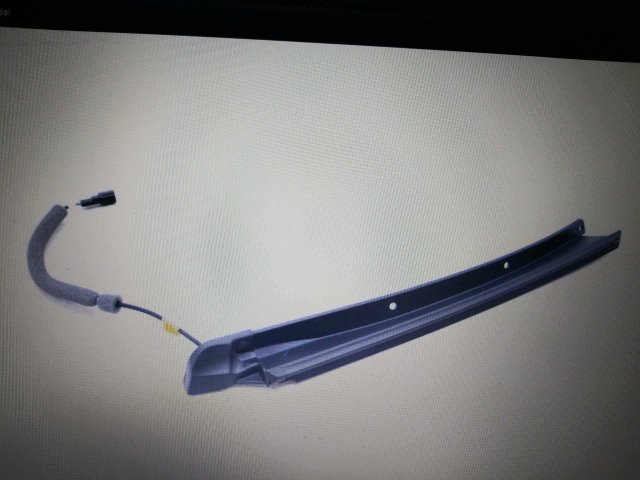

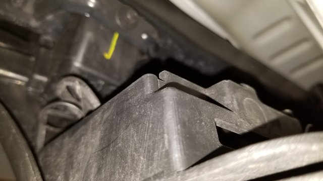

Found the f**ker and disconnected it. No more aggravation.
I took the best photos I could. The plug is located in a junction box on passenger side inboard of the exhaust tip. You cannot see the plugs as they face forward and are blocked from view, tough to see but you could feel for it. It is a single wire plug. I disconnected and no more foot activated gremlins.
This is what we are trying to disconnect. This is the part mounted in the bumper cover.
Here is the plug disconnected.
Here is the approximated area. You cannot see it without taking off bumper cover. I did not remove the cover. I felt around and tugged and squeezed plug and out it came. If you feel around and have keen sense you can feel it and remove from socket without removing bumper cover.
No errors messages on touch panel or dash with disconnected.
Sorry for poor photos.

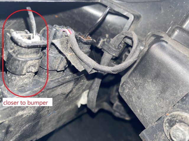

I just disconnected that connector, but here i my thoughts
1, after it stays disconnected both male and female plug stays exposed to dirt! not good, are there any solutions to seal these?
2, there are actually 2 single wire connectors. Not sure what is the one further away from bumper for
I think i will plug it in for now until i figure something to keep it sealed
