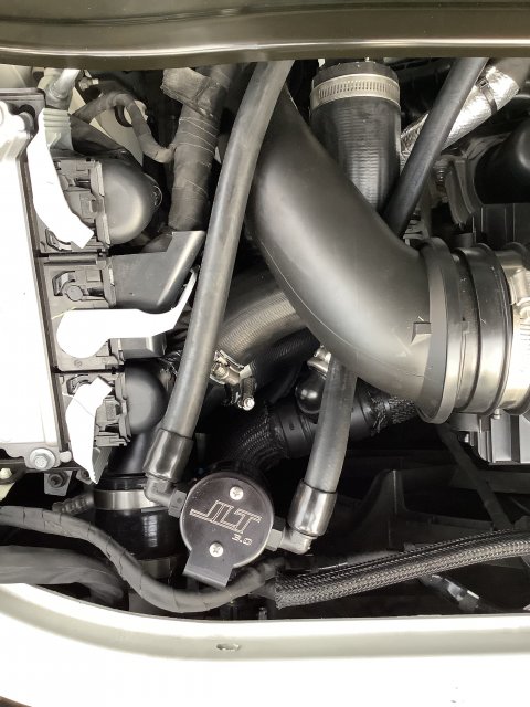

Mine literally took 5 minutes. I had none of the issues you are describing. Yes the plastic hose connectors are a bit of a PITA, but nothing like you describe. Hoses have plenty of slack, bracket installed fine.
edit to add pics.
1st pic - overhead shot, make sure it is angled towards the driver side via the bracket.
2nd pic - bracket attach location.
3rd pic - routing over and below intake piping

The install was easy, however I do find that one of the hoses is rather tight, maybe they had a batch where the hose wasn't the correct length. One hose was fine, the other not so much and I'd have to look again to remember which it was.

I should of taken a picture with mine "installed" to show proof of how tight the hoses were. Your top hose is loose compared to how mine was.
Same here, the one that goes over the intake tube is the one that is rather snug for me as well. Updated with a photo. 20210820_094640.jpg
