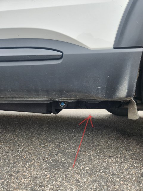

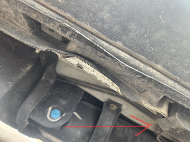

If your dealer is anything like mine beware. They had mine for a week to replace the smoked rear diff (because they didn't give it back to me with any fluid in it the first time) and I gave it a quick walk around at pickup yesterday. They completely mangled the Frame Rails. I installed lift pads on the pinch welds at the lift points and they didn't even use them. There are other issues I found as well. I'm actually at a loss of words at this point........... 20240303_074613.jpg 20240303_074659.jpg

If your dealer is anything like mine beware. They had mine for a week to replace the smoked rear diff (because they didn't give it back to me with any fluid in it the first time) and I gave it a quick walk around at pickup yesterday. They completely mangled the Frame Rails. I installed lift pads on the pinch welds at the lift points and they didn't even use them. There are other issues I found as well. I'm actually at a loss of words at this point........... View attachment 21936 View attachment 21937
Wow Viking, that's brutal...sorry to hear.
My dealer did the same thing soon after I bought it in 2020. It was noted on this forum that Explorers were not being lifted in the correct place. I knew I would be doing my own oil changes from then on. Dealer had their body shop fix it, no problems at all and even gave me a loaner. By now the service depts should have figured out where to lift these Explorers.
First, sorry to see what the dealer did to your vehicle. Hopefully they will make it right. Second, whose billet lift pads did you use? Seems like there are a number of people manufacturing them but mainly for GM and other manufacturers but nothing specific to the Explorer. I’m guessing that most would fit but since you already found some that work, I’d appreciate knowing what you ended up using.

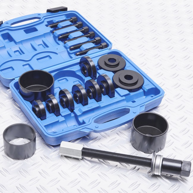

Attached is the earlier repair of the police units. The tool is shown in the doc.
Thanks,
I'd think that a bushing replacement tool shouldn't be so hard to source.
Edit:
Indeed. About 60 euro for a universal set.

Thanks,
Edit:
If you or I were doing the repair, that would be fine. When a dealership is doing the work for Ford, they have to work with the tools Ford calls out. If the dealership did the work with alternate tooling, and something happened later on, then the dealership would be responsible since they didnt follow Ford directions.
My dealership is also having issues getting the proper tooling.
