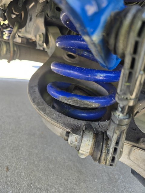

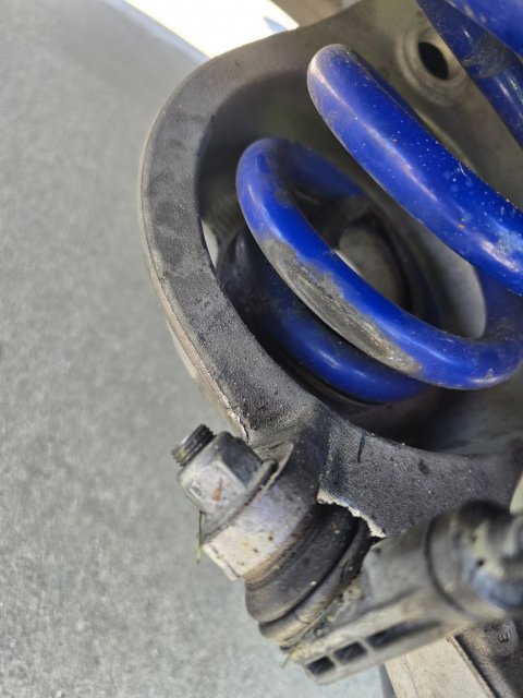

Mystery solved...anyone with Explorer Steeda rear springs manufactured in late 2023, there was a defect in Steeda's manufacturing process. The bottom and 2nd coil from the bottom should have been tapered or wound tighter. Without the taper, the spring was rubbing inside the perch causing the creaking noise. Thanks to Houston Speed Freaks and Nick at Performance SUV who recommended I inquire with Steeda. I sent photos and Steeda sent a replacement set of rear springs. There was an obvious difference of the bottom coils. The vehicle rides so much better and no extra noises.

Unusual defect. Glad you had someone savvy enough to spot the problem and send you in the right direction.
