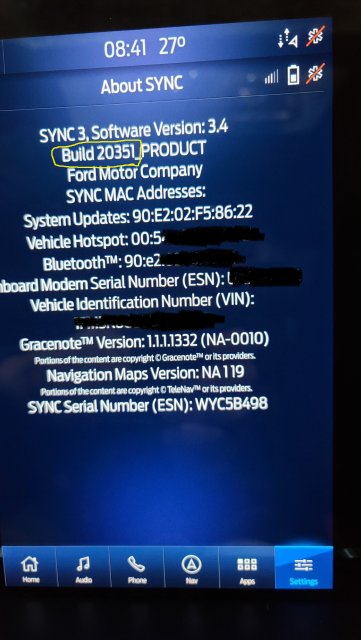

just updated to the latest from Cyan's site, it is a newer version (20351) than Ford site. Not sure of any difference yet. I wish there were release notes like every other software update from other vendors.
Do you have a link to this update?
364
201
Ashburn, VA
#36
When you download the Sync3 Updater and run it, it is a version option to select in the drop down box. There's also some chatter around if you google, but I didn't spend too much time yet, seems like a minor update. Still, release notes would be nice.. :)
