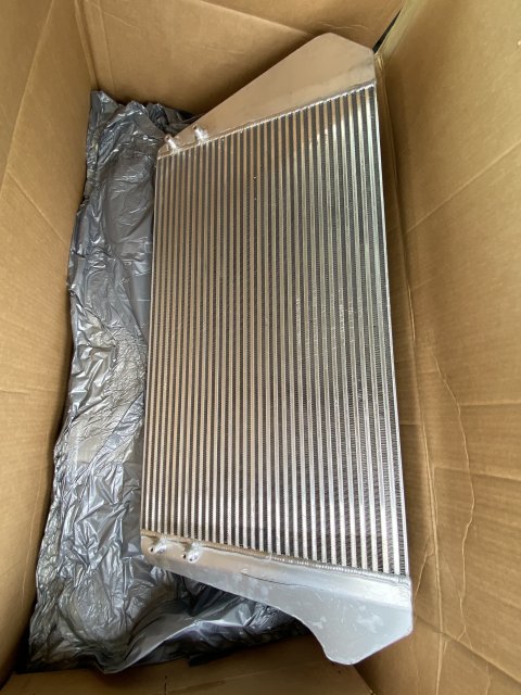

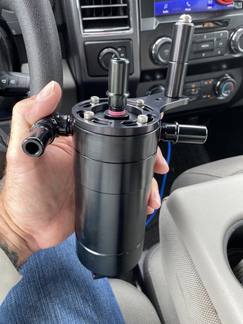

Got some new toys from Whipple and UPR...now I just need some free time. E7E6888C-EB3D-47EB-8D96-7C4938589CF5.jpeg 78980C4B-7FDC-4F84-8ABB-D79B6594461A.jpeg D350EAFF-7A52-459D-A485-FCDEBBF62657.jpeg

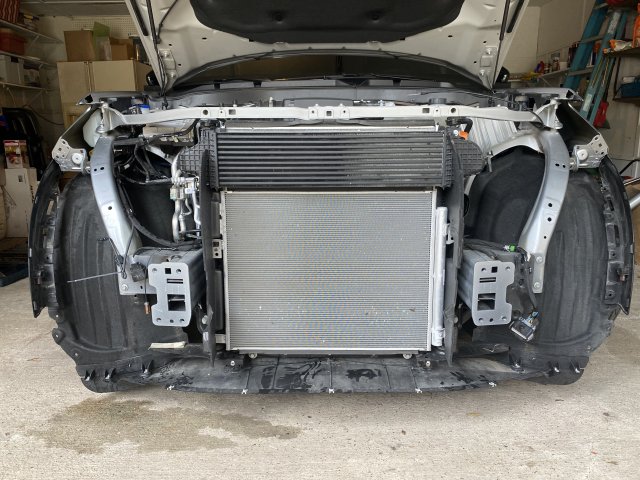

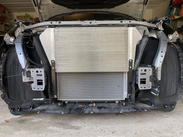

Nothing but intercooler in the grille now. I dig it. 00D39110-6050-4116-9613-F89833659B64.jpeg

So the million dollar questions become, a) how long did this take you, b) did fender panel gaps line up where they were supposed to when you were done, c) how many tools were required? I CAN wrench (have swapped motors and re-done suspension) if I need to, I just choose not to if the $/hr doesn't make it worth my time... I was always assuming I would need a pretty good mechanic to handle this for me but you make it look like an actually pretty easy job... i can even swap my front emblem while Ive got the grille off.

Took about 4 hours start to finish with a trip for a burger somewhere along the way. No crazy tools. 7, 8, 10 and 13mm sockets and a flathead screwdriver and you could do the whole thing. I used a fantastic write up sent to me by someone else. I have a digital copy if anyone needs it...it was invaluable. Shows every screw, bolt and plug for the whole thing with pictures.

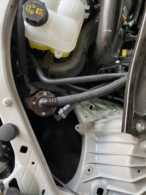

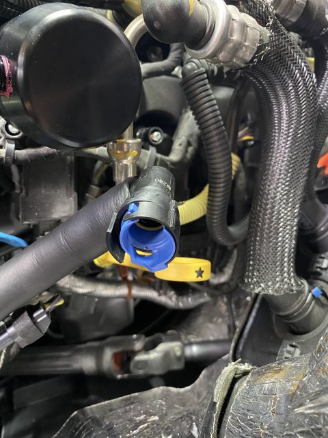

UPR catch can done....and a solution for the orange tamper proof fitting everyone fights. Take a thin flathead and break that orange bastard out of there...just destroy it...you don’t need it. Then take the short hose with the blue connectors, clip the side like in the pic here and slip the blue part out...it then slides right in where the orange one was. Done in 5 minutes. 0FBE40C0-15D5-4023-A0E0-67F333FB7E31.jpeg 18C73ABA-5370-4B69-B940-5FBFC621E34F.jpeg 437A639A-8FDF-40E4-A381-8393AD9AA97B.jpeg 705C5EB9-5E91-45AA-A3BA-CEFF3AA80CEE.jpeg C8BC37FB-1B7F-43A4-8854-74E054252DFF.jpeg
