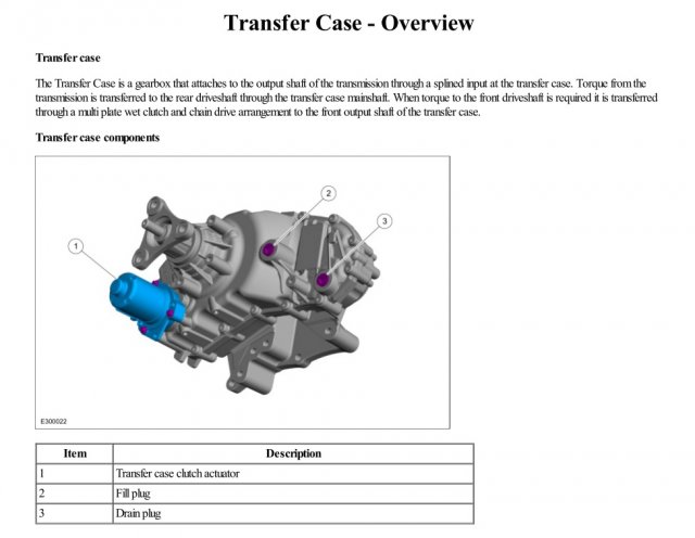

Today they changed the transfer case and the issue was resolved.
Everything works great -:)!!!
What`s part number you change?
Sharapov
21
Moscow
Changed:
L1M37A195AE
Sharapov
21
Moscow
In general, you need to look at internal errors and from there decide what to do

I’ve the same issues, I’m now replacing the front half shaft speed sensor, but I found out that the front axle is missing oil, it had around 300 ml while it should be 600ml, could this be the reason of a faulty sensor? I think it could

Replaced the front half shaft speed sensor. The problem is still there. What a bummer!
