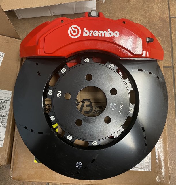

Brembos were delivered today. Rotors are shipped. And I’m about to get on a plane until Sunday then back on another one Monday. Guess I can wait a few more days....

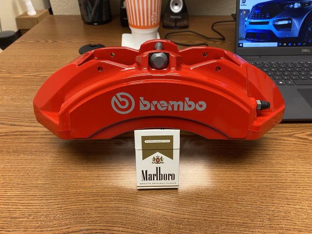

Up next...

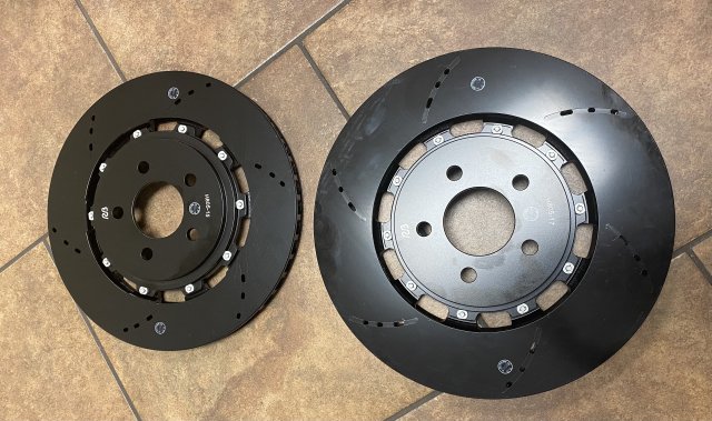

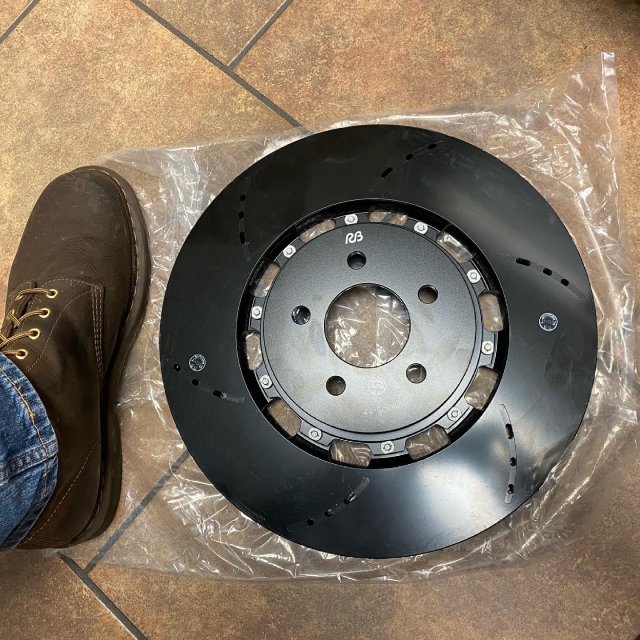

Can’t wait for Saturday.
In case anyone missed the RB thread somehow these are 380mm front rotors from Racing Brake to fit the SRT Jeep 6 piston Brembo calipers and PowerStop ceramic pads. The rear rotors are stock street pack size to retain the oem rear caliper with built in EPB.
