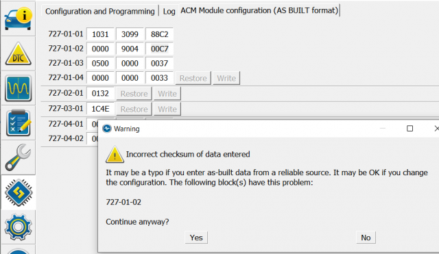

The grouping of restore write
Iirc is based on module group
It will write whatever you changed in the group.
The checksum error is pretty normal changing not normal as built sequences
If it all works OK. Please report back in pm
All you changed and codes used. So we can build common or adjust common to include 2025 items.
I will say killing the fake noise, does kill noise canceling and does make vehicle noise noticeable, especially on rough asphalt

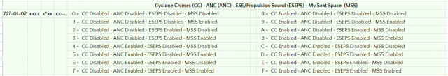

If the spreadsheet is correct, it looks like my stock value of X2XX has noise cancelling (ANC) disabled, and only ESEPS enabled in that group.
The value of X4XX would turn on ANC and disable ESEPS, but if ANC isn't on by default would it even work correctly?
Yes 4. Or 5 may work
Actually .. despite the numbers leaving active noise canceling ON, amd engine noise off, will by default in the B O. System turn off active noise canceling
This has been worked. Reworked expiremented etc in prior models
But as a 25 model
You are the test mule.
If you dr8ve with car in as built form and take some decible readings
Then turn off engine noise , but select noise canceling on. And then take another drive same speed,same everything and get lower decibels then we may be able to determine if this 2025 vehicle allows no engine noise, but keeps active noise on, as in the aviator
Remember many of the selections are lincoln only, as it has different module programing we can't change, even though we can see the path.
The center cluster for example
This is why folks with 25s should document very well what they find and or change so that information can be shared accurately
I wish I coukd go sit in a 25 at a dealer and test changes
I am going to carve out some time this week to really compare 24 to 25 module information
Nightshade is doing this as well
Iirc his 25 is inbound
Please post up what you find works
As a side note.on my 23 I turned engine noise back on, so noise canceling works
Our high traction asphalt roads create quite the drone
And now it's mitigated to a tolerable level
In my 22 f150 engine noise off has not effect on noise canceling and truck is very quite inside
