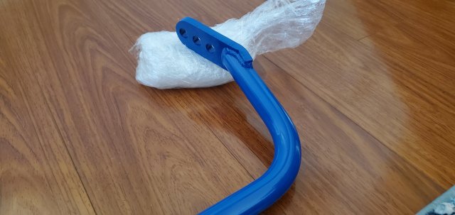

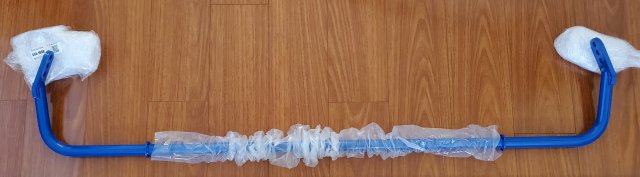

The Steeda rear sway bar arrived today, I took a couple photos to post here. Not sure when I do the install but I'll try to remember to compare the stock with this and get some photos.
After looking at the other photos posted in this I'm not sure if this is the updated or not, looks similar to me just sitting on the floor lol.

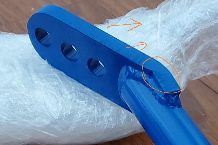

Looks like there is a small difference. I see a small 'bend' in the billet aluminum end, and it also appears that thesame end has been moved outward (from center of the bar) a very slight bit. Sorry for the crude 'photoshop' skills.

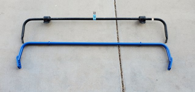

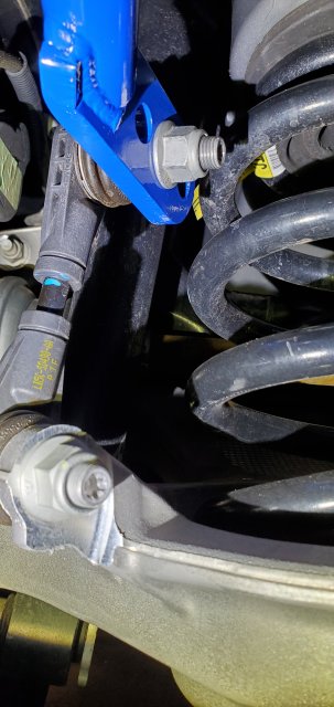

The plans that I had originally for this afternoon changed, so I went ahead and did the install. Here are bars for comparison:
Drivers Side:
Pass side:
Pretty obvious I'm on stock springs, one day I'll get the Steeda springs and put those in as well.

Looks like they made significant changes. Check out the original bar that I was sold compared to the stock bar.
seeing those photos it's easier to tell what was changed, thanks for posting those

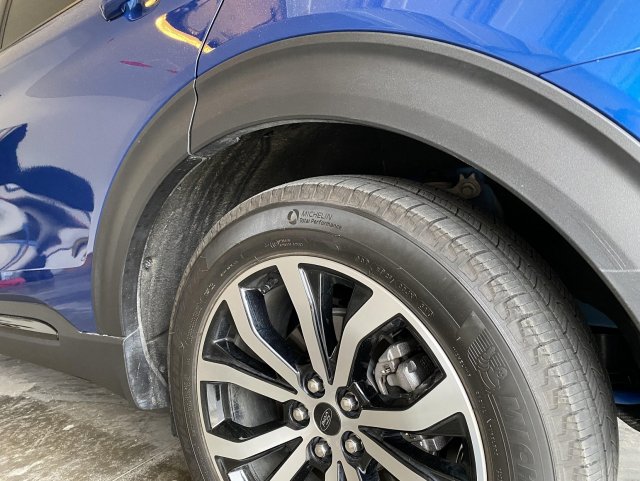

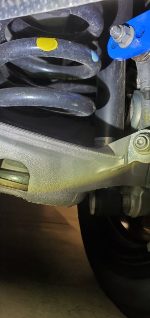

#80

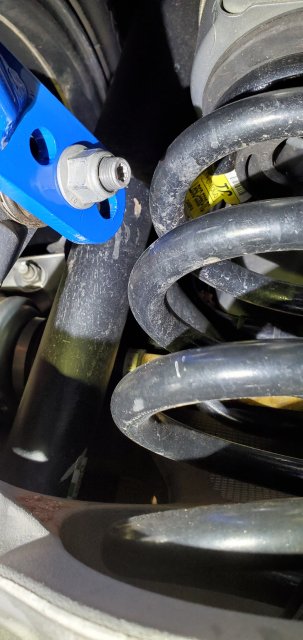

Got my Steeda springs installed yesterday. in the first image you can see both the RSB (it's dirty) & (left) rear spring. That is the original Steeda sway bar w/ the last hole cutoff. I've got a revised version (like @boosted_st 's) arriving tomorrow.
